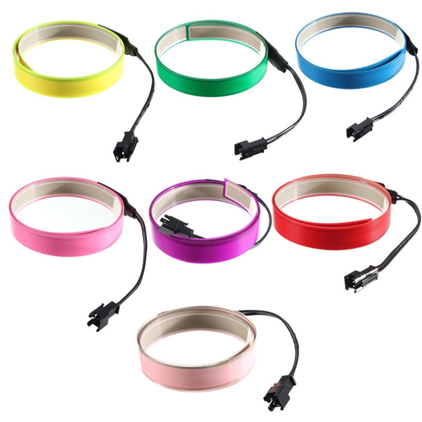

Hmmm . . . Fender lights. I'll still go with EL tape. Available in various widths, it should be easy to install and nearly permanent; showing yellow forward, red aft on the front fenders. It's plenty rugged as you'll find them used as "formation lights" on the F-22 and other aircraft that are adopting the feature. As far as wiring is concerned, I'd just tie-wrap it to the existing suspension arms or brake line if it couldn't be run inside a suspension tube.
http://electroluminescence-inc.com/ELtape.htm

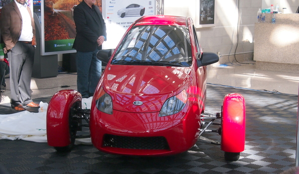

The fenders are so beautiful with its clean lines, I hate to add anything to them.
Maybe lights can shine on the fenders from the body, like airplanes.
Could lights be added to the body to illuminate the front and back of the fenders? How would that look?
Of course, there is no way of illuminating the outsides of the fenders, but maybe an led "artistic" pattern can be added to the outside.
I've never heard of doing this with a car, but then again the Elio is not a normal car. I love it! I can see mounting a few white lights on the body, pointed toward the fenders with perhaps some reflective tape on them as well. It would certainly be easier than installing/maintaining lights attached to a vibrating fender body.

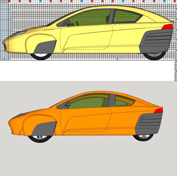

It's orange, that's the P4 and there have been a lot of changes since that prototype.

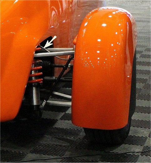

I used that photo [P4] because it was the only one I could find that showed the brake line. The E-1 has the brake line exposed as well. A flexible brake line should never be secured to any suspension component because the hose must turn and move with the front wheels.

I am not an engineer. But I do have a working knowledge of fundamental aerodynamics (I'm a pilot). Anytime you increase the frontal surface area of an object, drag increases. Adding lights to the [existing] Elio fender will increase drag because of the necessary wiring harness which is needed to power the lights. This will cause drag unless the wiring harness was integrated into the A arms of the front suspension.
