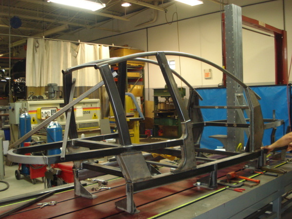

The Elio fuel tank is located in a structurally reinforced area beneath the passenger seat. We have not been told what type of tank is being used however most vehicles today use blow molded plastic fuel tanks and I would guess that due to their low cost EM will also. Elio Motors has told us that the fuel fill is on the right side simply because it is less expensive than putting it on the left.
You can see the tank mounting position under the passenger seat in this drawing:
The picture above shows how that area of the chassis is reinforced which protects the fuel tank in the event of an accident.
In this P4 rolling chassis photo you can see the single sided swingarm with the single coilover shock and the reinforced fuel tank area.

The Elio fuel tank location is actually very conventional as far as automotive engineering goes. The fuel tank is located under the rear passenger seat in the majority of cars today because over time engineers have determined that the safest place for the fuel tank is actually within the passenger protective cell. This somewhat counter-intuitive location does begin to make sense when you consider that the passenger safety cell area is structurally reinforced to avoid being deformed in an accident, is isolated from the engine by a firewall, and is not affected by the planned deformation of the front and rear crumple zones.
