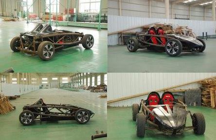

Certainly not my first gig with struts, this Exo-Sleton build I used struts all round

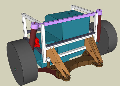

Hmm, can't find a picture of it, it's sitting in a corner of my factory, but here is the CAD model of it, uses the well known VW Mk4 Golf or Jetta 1.8 and auto box, and of course the VW struts.

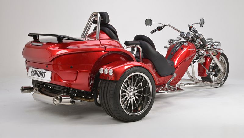

Was going to be this type of Rewaco Trike .....

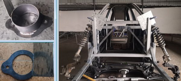

I am currently integrating the strut tops into the frame work.
I made up some strut tops with some simple tube which are certainly strong enough and simple, upper left, but quite complicated to work into the frame and making many, so I am going for flat plates, below left,
.... which I am home now figuring it out in CAD.
