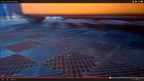

Well we know Eastern Catalytic will be supplying the entire exhaust system. We will just have to wait and see what it sounds like however I am sure IAV knows exactly how much back pressure the system will create and have taken this into account in the engine design. The exhaust will exit at a bit of an unusual location as the muffler is actually located under the passengers' feet with the exhaust exiting under the car near the right frame rail.
Man! That looks awfully close to the ground!
looks like a speed bump snag!
I think it just the angle of the photo as the vehicle is not actually exceptionally low to the ground. The P4 has 4.25 inches of ground clearance, however it is lower than stock on purpose for photographic reasons, and the final vehicle is supposed to be at 5.75 inches of ground clearance which is the same as a Mustang.
