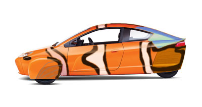

I've been thinking about a wrap because it's cheaper than painting the entire vehicle. My plan, if I can complete it, would be to purchase my Elio in a base color like Creamsicle and then complete a partial warp of stripes to create a orange and while pattern like Nemo.
Or, as an alternative, I would order the Marshmellow white and add orange stripes, which I think is a better idea because then, providing I can remove the wrap, I can change my wrap to the '57 Belair image by pealing the orange off and adding the different wrap to the base coat color for a new look.
I've never done this, and if there is trouble removing the wrap, then I won't be happy. That will be one of the critical questions that I'll have when I come to that decision: How difficult is it to change wraps? I've found a local vendor that will wrap my Elio for me and when I take delivery, I'll be visiting them for a quote and Q&A session about pricing etc.
I was very partial to the WWII airplane scheme or the Formula One racer scheme but I believe that the personality of my Elio will be more suited to be "Nemo" or a Belair than a racer. But that's just me...

If you're going with a Nemo look, are you going to oversize the left front fender (fin) and/or undersize the right? :D Don't forget the black edging between the white and orange.

I think you are looking for something like this:
View attachment 442 something fishy here... Where's Nemo?

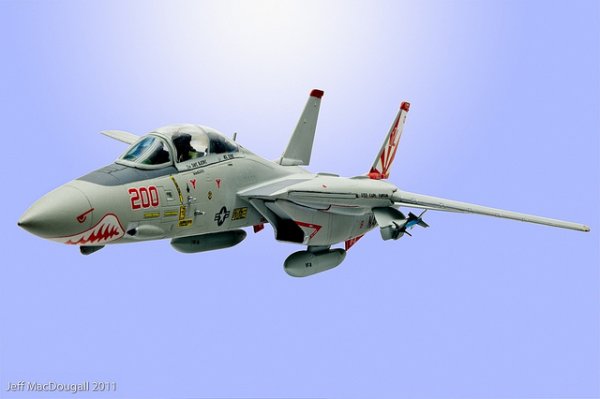

Agree with you, except one small point. I believe it was the F-14 that was the Tomcat; the F-111 was the Aardvark.
You are correct, the F-111 is the Aardvark,:) but "VF-111" is an F-14 squadron (the Sundowners) that was in my hangar back in the early '80s (I was in VF-124, the other squadron was VF-211). All the VF-111 planes had the shark teeth, but only the Commanding Officer (pictured) had the cool red and white paint job...the rest were just different shades of grey.
