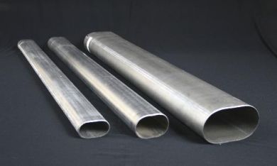

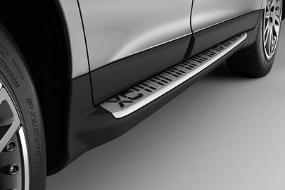

Nice drawing and concept. An alternative would be to consider an oval (elliptical) pipe, instead of the OEM round pipe, and then build that into a running board, with a matching one on the other side. This will provide you with both symmetry and the appearance of an integrated functional part, instead of just a bulge with no other purpose than to hide the exhaust. I haven't done the calculations but would guess the change in pressure drop would be negligible.
