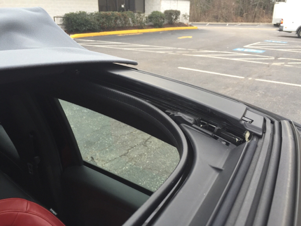

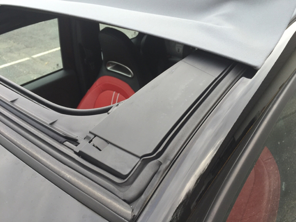

Someone in here has the Fiat with the sliding roof, ask him to measure it on the outside of the material and then compare it to the true opening width on the inside; there's about 2" of overlap on both sides that is frame work. So outside is one size, the inside should be about 4" smaller side to side.
That's me.

If you don't mind forgoing the sliding mechanism and a perfectly weather-tight seal, it could be packaged quite a bit smaller. I know Jeep Wrangler soft tops just use a strip of plastic around the edge that slips into a groove that's no more than 0.75" wide. That setup should fit nicely on top of the frame tubes and the taper would likely help with the install.
