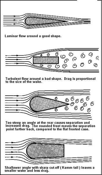

Can someone please explain to me how having a square rear end of the vehicle and the wheel fenders is aerodynamic. I have been told this is aerodynamic by the tour people.
If this is aerodynamic, than all the airplane designers have it wrong by tapering the tail of planes.

It has been explained before elsewhere, but the squared off back end is a compromise between added weight/length and optimal aerodynamics (imagine trying to parallel park a fully tapered mini-van size automobile). For planes minimizing drag is critical to performance and the added weight of the fairings makes up for itself at higher speeds, so the designs reflect those differences.

If you're asking how the square back end is better than a rounded one that isn't appreciably longer, that's a lot more involved. The best brief description I can give is that a properly designed flat end tends to create a stable bubble of turbulent flow behind it that is smaller than the one you would have with a rounded design on average. The key is to make the shape of that bubble taper aftward, using it as a sort of virtual fairing. This picture describes the effect fairly well:
I think it looks good and would not want it tapered. The aptera tail looked ridiculous and ugly.
Well, you're actually on the right track! "camback" cars truly are based on the "wing" style, only without the tapering end. Here's why, Airplane wings are designed to "lift" the plane. if you turn it upside down, it would firmly plant that same plane hopelessly on the ground. If you've noticed, the side view of the Elio isn't far off what the same view of an airplane wing is! This is without the addition of the rest of the wing, as no one needs it hanging out back there, and it would actually create an instability while driving under varying conditions.
When you look at the Elio from the top view, you notice it also curves in at the back. This helps the Elio remain stable at speed, as well as giving the air going around the Elio a "curved plain" to travel along. This, redirection of force, if you will, reduces the vortex air behind it, as it's already angling towards the same air flow on the other side of the vehicle. The vortex is actually unstable air, and creates a lot of backward "pull', harming mileage at higher speeds.
I guess the easiest way of saying it is, with the inward curvatures of the roof line and the sides of the vehicle, the rest of the "wing" on the back isn't needed, as the already redirected air meets well behind the moving vehicle with far less vortex turbulence.
