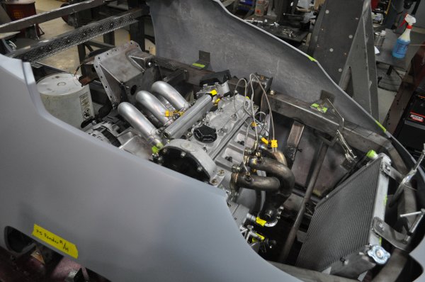

You can already see some of the post-P5 changes. Note the extra L-shaped brackets and cross-brace providing additional support and rigidity in the engine compartment (starting from the base of the windshield). Note those braces are not in the P5.
View attachment 9427 View attachment 9428
They are in the P5, but not in that early picture; it's something that came about when they were fitting body panels.
There are a LOT of pictures of the P5 during construction, but they were spread out over time and the communication forms (blogs, Facebook, their website and even during the show and tell events) I have a collection of 143 pictures I've collected over time showing the P5 during construction and you can see little bits and pieces that changed during the build.

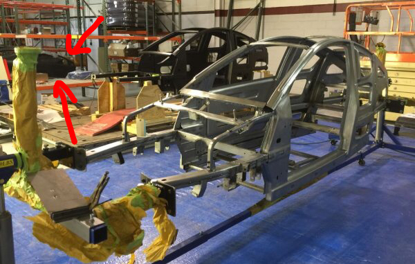

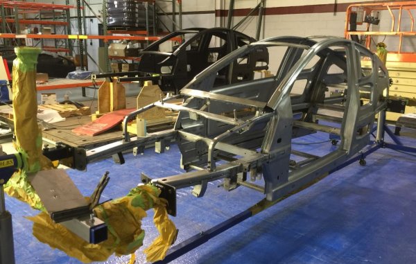

Something else just caught my eye -- the forward-most (curved) frame member now mates to the longitudinal members via flanges, which appear to be drilled (at least in the diagram). The P5 frame was just welded at those points, I'm pretty sure. So -- do the flanges provide extra rigidity? Are they really bolted, or bolted plus welded? If just bolted, that would make repairing front-end damage a lot easier, but bolts do work lose ... what's your take, O Gearheads?

Studying the chassis drawing and builds, it looks pretty clear that the entire front suspension is one unitized assembly that can easily be installed, dropped/changed with only a few connections. This is a great design/engineering feature that facilitates economical initial assembly, maintenance and repairs and may save a good many wrecked Elios from salvage.
Hopefully they can figure out how to include the entire drivetrain in that removable cradle so it all comes out in one piece.
I also don't see any tubular steel as in the prototypes...I am seeing conventional stamped sheet metal members creating a welded unibody.
