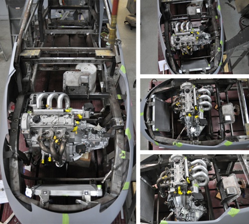

Pictures Of The P5 With The New Motor
Ekh --- The clutch system is actually very simple. The pedal box appears to have the mount for a hydraulic master cylinder. A steel line from the clutch cylinder around the frame to over the end of the transmission then a flex hose to the slave cylinder and you're done. Doesn't matter where the clutch fork is located. The procedure is the same. Shifter would use 2 teleflex cables for X and y axis shift control. There again a couple of cables and 4 brackets and you're done. I love manuals.
Looking closely at the clutch fork I figured it would be cable controlled. A barrel on the end of the cable with the barrel engaging both sides of the clutch fork. Cable would probably be cheaper than hydraulics.

William --- I thought they would use a clutch cable myself but the master cylinder mount hole in the pedal box sure makes it look like they're planning on a hydraulic clutch system. I'm sure cable would be cheaper but they may well be factors involved we're not aware off. Hydraulic systems are always very light where as cable systems tend to get a stiff and heavy feel when they get a little age on them. A little concession for us geezers on the customer list.

More pictures!!
September 28, 2015
Hello Coss,
One of the questions Paul Elio is asked frequently:
“Why did you build your own engine? Wouldn’t it have been easier to simply get one that’s already on the market?”
In a nutshell, nothing existed that provided the combination of power and fuel efficiency that gets us to 84 MPG while maintaining performance characteristics on par with today’s vehicles.
Elio Motors turned to IAV, one of the world’s pre-eminent engine builders, to design and build a new engine from the ground up. IAV has done work for the likes of Mercedes, Bentley and BMW and has un-paralleled technical expertise.
The first engine prototype was officially unveiled March 6, 2015. It was tested on a dynamometer, and then disassembled so each individual component could be analyzed. After making a few minor adjustments, another prototype engine was developed and assembled by IAV.
On September 21, 2015 that engine prototype was assembled to the Elio Motors P5 prototype frame, a major step forward in our development.
Now it’s time to keep the momentum going. The funds for the P5 and some of the most recent steps in the IAV engine development were made possible by a crowdfunding initiative we launched last March. Our latest crowdfunding initiative, in which you have expressed interest, will be used to develop another 25 engineering vehicles for a variety of testing and validation purposes.
Adding the engine to the P5 chassis is one of the most exciting milestones we’ve hit this year. We’re looking forward to rolling out the finished version in the near future, which in large part, this is all made possible thanks to the enthusiasm for Elio Motors exhibited by people like you. As we continue our journey to the production line, we wanted to thank you again for believing in our mission.
