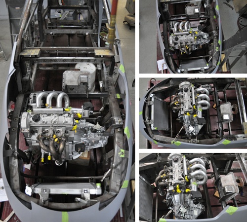

Pictures Of The P5 With The New Motor
More pictures!!
September 28, 2015
Hello Coss,
One of the questions Paul Elio is asked frequently:
“Why did you build your own engine? Wouldn’t it have been easier to simply get one that’s already on the market?”
In a nutshell, nothing existed that provided the combination of power and fuel efficiency that gets us to 84 MPG while maintaining performance characteristics on par with today’s vehicles.
Elio Motors turned to IAV, one of the world’s pre-eminent engine builders, to design and build a new engine from the ground up. IAV has done work for the likes of Mercedes, Bentley and BMW and has un-paralleled technical expertise.
The first engine prototype was officially unveiled March 6, 2015. It was tested on a dynamometer, and then disassembled so each individual component could be analyzed. After making a few minor adjustments, another prototype engine was developed and assembled by IAV.
On September 21, 2015 that engine prototype was assembled to the Elio Motors P5 prototype frame, a major step forward in our development.
Now it’s time to keep the momentum going. The funds for the P5 and some of the most recent steps in the IAV engine development were made possible by a crowdfunding initiative we launched last March. Our latest crowdfunding initiative, in which you have expressed interest, will be used to develop another 25 engineering vehicles for a variety of testing and validation purposes.
Adding the engine to the P5 chassis is one of the most exciting milestones we’ve hit this year. We’re looking forward to rolling out the finished version in the near future, which in large part, this is all made possible thanks to the enthusiasm for Elio Motors exhibited by people like you. As we continue our journey to the production line, we wanted to thank you again for believing in our mission.
We look forward to keeping you updated as we move forward.
The Elio Team

The engine seems to be more or less resting on its mounts. There's only one bolt sticking up from the left hand mount (port side). But-- I think I spy the clutch pedal (which seems a lot like the pedal I used to use to kick stat a bike back in the day) in the lower right photo.
The hole for the steering column is obvious. How they will route stuff for the clutch fork, which is on the forward side of the engine, facing away from the driver's seat, seems more complicated. Ditto routing the steering linkages. LOTS of stuff to do, and I hope EM will continue the progress shots. They help a lot, both in understanding the product and in building our enthusiasm.
They really are making progress with this puppy. I can't wait til it gets sent off to obedience class!

Ekh --- The clutch system is actually very simple. The pedal box appears to have the mount for a hydraulic master cylinder. A steel line from the clutch cylinder around the frame to over the end of the transmission then a flex hose to the slave cylinder and you're done. Doesn't matter where the clutch fork is located. The procedure is the same. Shifter would use 2 teleflex cables for X and y axis shift control. There again a couple of cables and 4 brackets and you're done. I love manuals.
