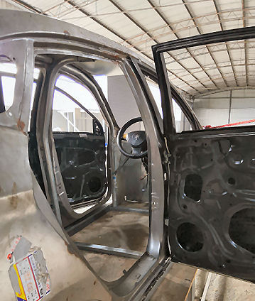

Because the roll cage is partially welded in, it's has enabled me to hang the doors of it and release the rear door from it's welded tabs.

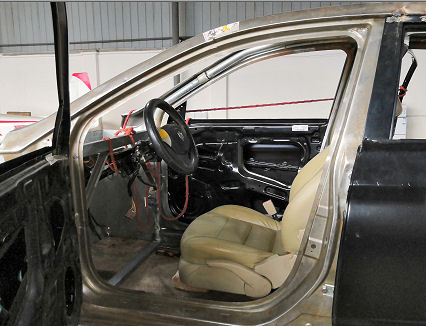

And playing with the cabin arrangements, there is more room than I anticipated for the taller and wider guys who were concerned.
much appreciated as while I'm certainly not one of the taller guys, I'm most certainly one of the wider ones :D
