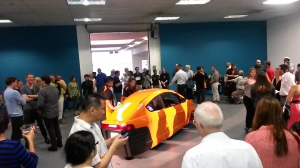

It was nice to see PistonBoy and Bliokart. I got a pic of the new "Tiger" Paint Scheme :
