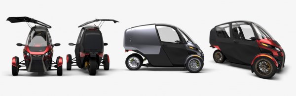

Well Im ready... but I wonder how this will go over with the Law Enforcement personnel on the army base where I work. They have pretty strict rules for motorcyclists and they seem to be very inflexible. I can imagine rolling up in my SRK and being turned away because I am not wearing a reflective vest, jacket, boots, gloves, or a helmet. So that pretty much negates 90% of the traveling I would do in it.
I might concede on the boots/gloves/vest, but not the jacket/helmet.
Sethodine
Aug 30, 2015
1,665
4,228
Mount Vernon, WA
Well, seeing as the SRK isn't fully enclosed, I'd probably go with the jacket too unless it's pretty warm where you live/work. But yeah, I agree helmet is excessive when it already has a windshield, roof, roll cage and seat belts.
7,174
Side panels allow for open or enclosed riding to include climate control on the production model. There will also be an enclosed single seater Deliverator SRK.
