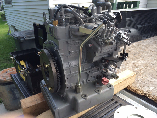

I think that Diesel would see pretty good improvements for City numbers, but not highway. If the engine in my Elio ever blows I might swap it out with something like this Kubota D722 I have laying around.
