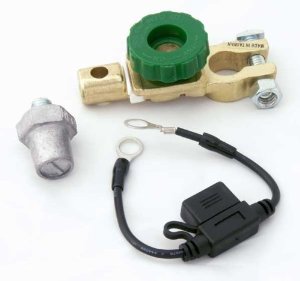

I've used a number of battery cut-off switches over the years, and placed somewhere out of the way where you won't notice them, they are inexpensive and really effective. Battery switches are required on most racing classes, because they can quickly disconnect the battery in the event of a crash. Several types are available:
[Broken External Image]
They fell out of favor on family cars a while back because disconnecting your battery causes all of your car's stored memory to evaporate - like your ECU, radio stations, and preferences in your "body computer".
But there's a simple fix for that. Bridge the switch with a 5A fuse, seen as the black jumper in the right photo above, or for a neater installation, run a lead back to your fuse block and install a fuse in one of the empty sockets. This jumper will provide power to your memory devices, even your dome lights when you open the door - but try to start the car and the fuse pops, leaving your car dead in the water. The only way to get the car underway is to locate and throw the switch, but on a dark street any self-respecting thief is going to move on to something more expensive and saleable than your Elio. You'll forget to flip the battery switch occasionally, so carry a few spare fuses to restore normal operation before using the switch again.

Just remove the ignition fuse. Allows you to maintain the memory on everything, still disables the car and is very cheap.
