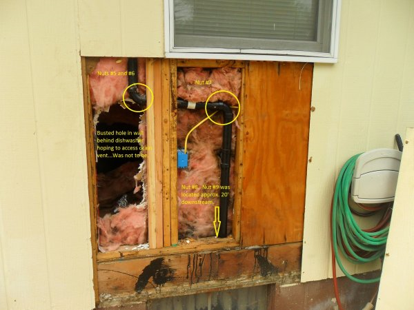

Got home after a long day at work yesterday, wife tells me the kitchen sink is backed up. Went to the store and got a jug of Liquid Plumber, dumped it in and let it sit overnight. Still clogged when I woke up. No problem, I'll swing by Lowe's on the way home and pick up a 25' sink snake. Ran the snake until it went all the way to the main vent stack...not draining. WTF?!o_O Didn't seem possible, but I was running out of feasible causes for it not draining. So I got up on the roof with a flashlight and looked down the vent connected to the kitchen sink...Holy Sh*t!! :eek: It's filled to the top with black walnuts!! Got out as many as I could, but it's apparently chocked full! This is going to be a messy job for sure. It's on an exterior wall, so it looks like the siding's coming down to get to it. The neighborhood squirrels have just made the 'hit list':mad:, and I've got just the thing to take care of them (JEBar knows). Bad enough they take one bite out of every vegetable growing in the garden, but now it's going to cost me time and money. Just what I wanted to do this weekend!

It took some major deconstruction [destruction] of my house to get them all out (9 total), but it's draining like it should now.

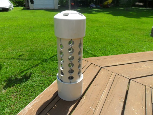

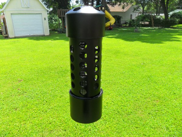

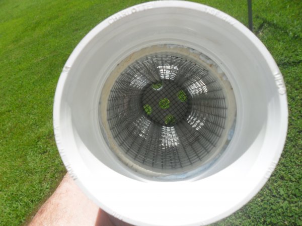

Okay...Made a compromise (out of argon, no flux-core wire:mad:), went with PVC. Turned out kind of like the CAD drawing more or less. Hope they run up to hide their nut(s), and say, "WTF! (in squirrelese, or course)", and run to the house next door (kickstart program for future sales!;)). Pretty simple, hope they do the trick. Throw some voltage on it and it'd make a descent bug zapper!

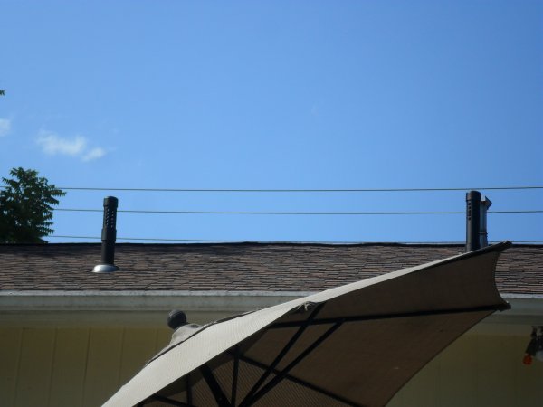

I did one for the smaller pipe that got "squirrelled", same concept. The ones going after my garden are still on the "hit list".:boxing:
