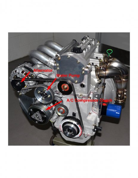

Ah, but the AC compresser is longer than the alternator, as well as almost as large in diameter. We'd see a "hint" of it under the alternator is it was already mounted..
The beautiful intake manifold would give us this "peek" between the passsges if it was there.
Just to make things real clear

The advantage of an electric AC compressor is that it can run at its optimal rpm rather than be fixed to engine speed. This means that a smaller unit can be used with equal effectiveness and higher efficiency. But it costs more due to the need for an electric motor and higher amperage electrical system needed to power it.
ANOTHER ADVANTAGE IS THAT IS DOES NOT NEED TO BE MOUNTED ON THE MOTOR .
IT COULD BE MOUNTED ANYWHERE THEY CAN FIND THE SPACE FOR IT .
