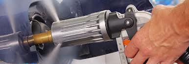

I can't speak for the crowd , but finding a fuel station that sells Diesel near my home is a factored annoyance . If I were ever tempted to veer from the convenience of gasoline , it would certainly ONLY be for LPG . Traditional engines can easily be converted to LPG and provide lower fuel costs, 20% lower CO2 emissions and no particulate emissions at all . Cleaner burning fuel reduces wear and adds additional life to your traditional engine.
So , if I have to hunt for a station to fill my vehicle , I will only hunt for a better alternative .
Side Note:
If I were in a position to make regulations , ALL US commercial vehicles would be running LPG .
