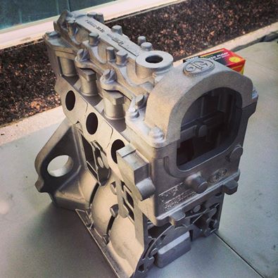

Am interested in your thoughts Ty... they said this was an aluminum casting of the engine. What does that mean, to those of us that know nothing about building engines?
Does this mean they are close to starting on building the final engine? I read the EM marketers say that the design of the engine is complete. From my point of view in software development, there is analysis, design, build, test. Is there a way to know, from the above casting, that IAV and EM are in the build phase?
14,762
Jeff, I can't answer that with much more than a guess. IAV may have cast this one in aluminum to ensure fit while keeping it easy to move around. Pulleys and brackets and such will have to be fit to the block. If aluminum is the final material, which I think it is - Flame spray will harden up the cylinders saving weight over sleeving each cylinder with steel. So, yeah, I'd say this is the engine that will get accessories and eventually put on a dyno to check balance, noise, harshness, vibration, power, fuel consumption, etc.
I've built 7 or 8 engines but have never been involved in casting them. My engineering skills are in making the processes more efficient but not in mechanical design. Anyway, it doesn't take long to machine the engine and assemble it. They'll have to ship it to Flame Spray to get the plasma arc spray done on the cylinders before honing them but that shouldn't take too long. I'd guess in a couple of weeks, they'll have it mostly together and then will be designing brackets to hold the AC, alternator, power steering (if not electric or non existent) stuff. So, early September, I'll be looking for videos of the engine on a test stand being checked. Shortly afterwards, it could be in the car... They haven't said what transmission they are using yet, have they? That'll have to be decided before installing it in the car, too.
