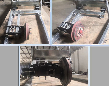

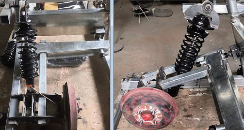

The swingarm has turned out quite nicely, easy to build with minimal common materials, and self jigging for welding.
Importantly, fully and easily adjustable for tracking and camber.
Out of curiosity, was the decision to have changing the rear wheel on the right or left determined by exhaust routing?
The suspension strut should be on the left so that the person putting things into the cargo area tends to stand on the safe, non-traffic, right side.
