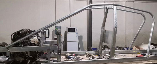

Ok, it seemed to have worked out, now the front and rear rollbar sections now only have one bend each, and joined with a kink at the B pillar..
I was confident after lining them up, that I even semi welded them into place, just enough for strength, but also the ability to remove them if there's an issue later I didn't see.

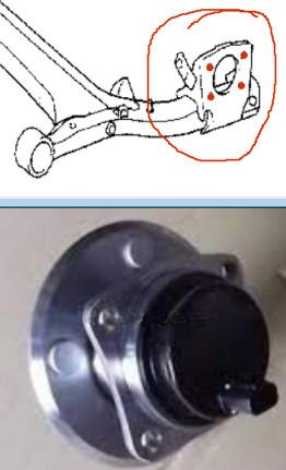

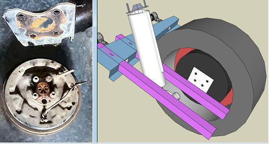

I am currently redesigning the rear wheel swingarm, and using the Honda engine donor rear wheel assembly for it, for good reason.
The rear wheel assembly bolts on to a flat surface with 4 x bolts, see picture, drawing of the car's rear beam axle showing the flat mounting plate, and a rear wheel bearing. I will laser my own mounting plate of course.
This allows the use of shims to adjust the rear wheel alignment much easier than what I had built on the prototype, now simple adjustment can be made for tracking and tilt.

Rear brake gonna be a "Drum" or Disc?
Light weight vehicle and Drum should be OK. .....KISS
The rear is drum not just because of the car's lightweight, but because the parkbrake is far more effective on a drum than a disc. ... in fact, many rear discs have a drum brake on the inside of them.
Plenty of small cars still use rear drums, Chev Spark for example.
