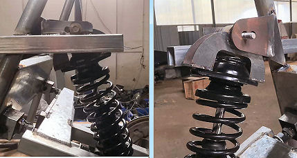

Getting the rear suspension frame mount sorted out, went smoothly, should work out good.

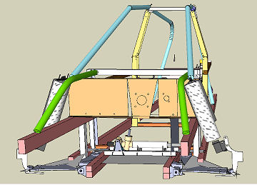

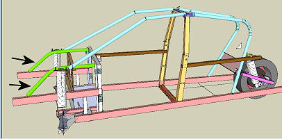

I struggled with the front suspension today, just couldn't get the setup that I wanted, so I have to make changes, serious changes, but not difficult to implement.
The the front roll cage extending all the way to the front will be truncated, and the green tubes (black arrows) will be added, and you can see in the CAD how the front suspension top mounts meet the new tubes.

The new tubes only have one, non-critical angle bend, and meet at current nodes on the frame, so no frame modifications required, more like a simple addition. .

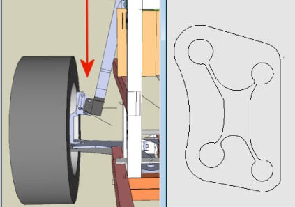

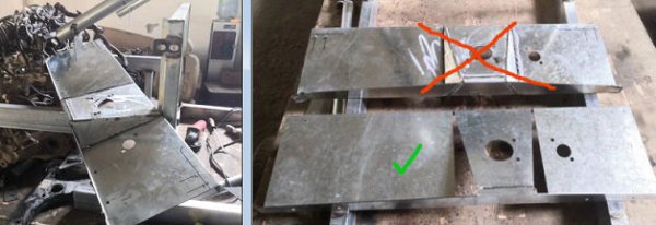

I always like to show something on the weekend, but 1/ not very exciting and 2/ forgot to take a picture anyway!
I laser cut some adapters to mount the front suspension to the steering knuckles, and working out a problem I had with the other prototype that is seeing too much stress on the upper suspension bush when turning on full lock.
