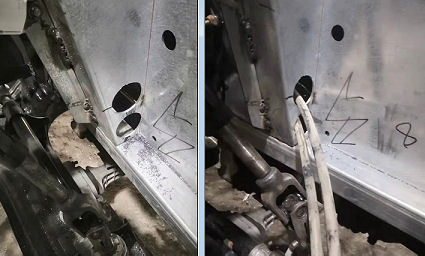

I went in blind as regards to the gearchange cables, had no idea what I was going to do with them when I got to that stage. It turns out I got quite lucky!
The side walls of the brake booster firewall are just in the right spot and size for 2 holes for the 2 cables,

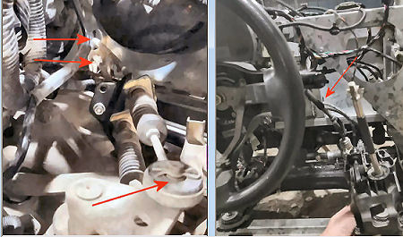

... maintaining a straight line from the gearbox gear change linkages (red arrows, bit hard to see).
The black bracket that holds the gearchange cables, also supports the clutch cable, I fitted it, was an easy routing, and now I have working clutch

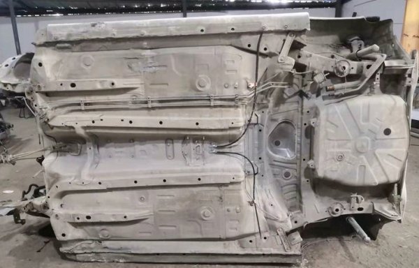

The donor went on it's side to get some bits I need.

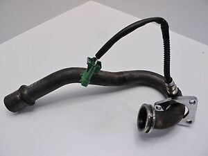

There is 8 earth leads in the wiring loom, I had 6 earthed out, the issue was a small earth lead from the OCD2 check port that I didn't even see, and the lambda O2 sensor (oxygen sensor) in the exhaust has an earth but the header pipe wasn't earthed out to the engine.
Not mine, but here is a random header pipe with O2 sensor, I had it plugged in, but the pipe wasn't connected to the engine, i.e. not earthed out.
All good now.
