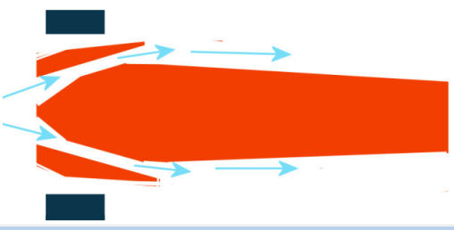

Have you attempted a test body panel fitment to see how much the front is going to have to be modified to accommodate those struts? After seeing the front view it's got me curious.
I got a general idea, clearly the panels have to splay outwards, and on the inside of the panels is where the air is going to flow/escape out from the front through the radiator.
Does that make sense?

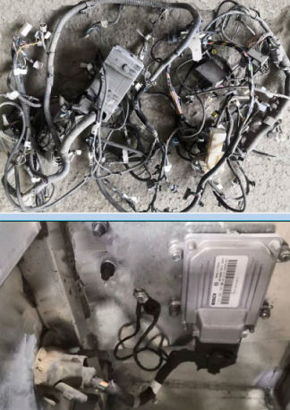

Well most of the wiring loom is plugged in for the engine side of it, still some to go, but I have run across an annoying issue: The wires are too short because I have moved the steering wheel over some 3" or 4" relative to where it and the fuse box were in the 2 seat donor car.

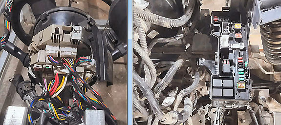

The are some 15 connecting plugs that go into the back of the instrument panel, pictured left, mounted on the steering column, so I ain't changing them! I have to get creative with the mounting of the fuse box, pictured right, to make up some of the length deficit, and hopefully the only issue later will be that the stock wiring loom wires are too short to reach the headlights, shouldn't be hard to fix that, or you lot can just drive only in the daytime and save me the bother.
