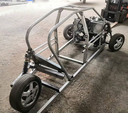

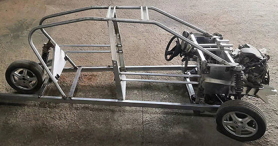

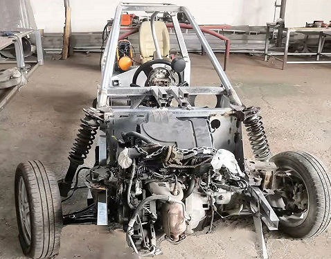

Finally on it's wheels for real, with steering and brakes.
More work to be done, I see it's too low at the front, at least by 1" or more, easy fix as I had planned ahead for it, and I have to make the brackets proper for the suspension to steering knuckle joints.
Good news is the front spring rates feel about right, no reason they shouldn't be close considering the similar weight at the front of the donor.
The rear spring, which is the same as the front, I'm not sure yet until I can get to having a full tank of fuel and a person's weight in the back.
Of course will be great if all 3 spring/damper units are straight "off the shelf" and identical.
