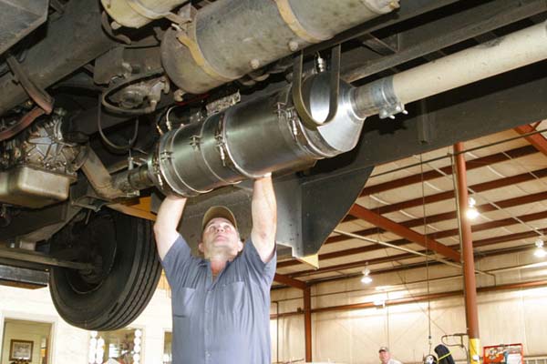

Here's one. (combo) Should not be a problem.:rolleyes:

The word combo on most searches come up "in combination with a muffler" not all in one.
I would bet it is not really one unit but instead just bolted directly to the exhaust manifold and installed on the car as one unit. My Honda Civic is set up that way.
Modern catalytic converters flow very well and the drivetrains are designed with them in mind so they don't affect mpg nearly as much as they once did.
