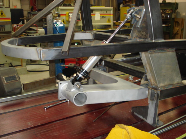

Taking a look at the P4 rear end makes it obvious that there would almost certainty be clearance issues on the right side between the swingarm and shock moving in this area and the muffler. As it is drawn the packaging is going to be very tight on the left as well however with the wheel centered there should be just enough clearance for the muffler to sit on the left in the same area the swingarm and shock take up on the right.
My guess is that EM is counting on the real wheeling dropping just low enough to be serviced when the vehicle is jacked up. Packaging is tight everywhere in such a compact vehicle and my guess is that this is the KISS (keep it simple, stupid) solution that balances cost versus getting the job done.
My guess is that EM is counting on the real wheeling dropping just low enough to be serviced when the vehicle is jacked up. Packaging is tight everywhere in such a compact vehicle and my guess is that this is the KISS solution that balances cost versus getting the job done.
KISS? Lower shock mount bolt same size as lug nuts, drop swingarm and plenty of room for wheel tire brake etc service.

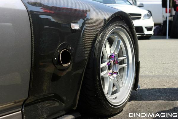

Meh, doesn't matter. First thing I'm going to do is cut it off and make a dump pipe exit the right side. :cool:
The place to do it will be where it appears to turn left to cross over just behind the gas tank.
That will put the dump pipe right in front of the wheel on the right side. Perfect! :D
