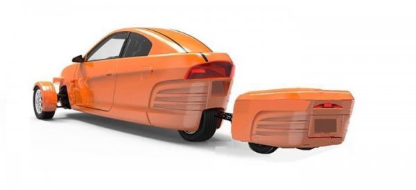

If you look around you can easily find narrow and relatively light utility trailers which would be perfect for Elio towing. My plan is to build or buy something like this:
Both of these trailers are relatively light and inexpensive as they both came from harbor freight. The first one is built on a harbor freight chassis and uses a standard roof carrier bolted to it and the second one is a complete harbor freight unit.
Base trailer without storage unit - http://www.harborfreight.com/870-lb...ailer-with-8-inch-wheels-and-tires-42708.html
Complete Trailer - http://www.harborfreight.com/600-lb-capacity-78-inch-tag-along-trailer-66771.html
There are a few inexpensive upgrades which should be done to these inexpensive trailers to make them ride better and lost longer. It helps greatly to upgrade the wheel bearings and pack them in good quality grease as this will make them last a long time without giving you much trouble along the way. Isolating the leaf springs using some thick rubber pads will make the trailer handle much nicer. Also upgrading the wheels and tires plus purchasing a spare at the same time will make everything ride nicer and save you hassles down the road.
I like the size of that trailer. I hope the attach point extends past the wheel (the ball) so that you can make left turns without hitting the tire. I know it's just a graphical representation of an idea. But, I hadn't thought about how the hitch will have to attach ahead and beside the rear tire and extend back. Nice trailer though. I want one.
