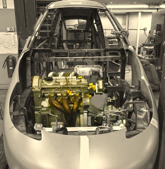

interesting .... once they get things ironed out, I'd tend to believe that the interior will more or less be pop-in or quickly bolted-in segments .... I can see how having to make the frame ready to accommodate the installs could take a while .... I bet that motor and tranny have been taken in and out a bunch of times already .... it would really be nice to see a picture of the P5 as it stands today
According to Jerome, they have had the whole engine in and out several times as you suggest, body panels on and off repeatedly, etc.
