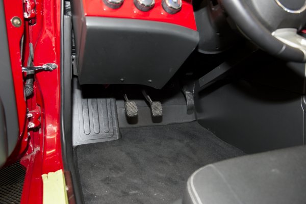

For what it's worth -- I have tried the clutch pedal in the P5. It is really stiff. If they don't find a way to relax it some before production, I will be buying an automatic.
