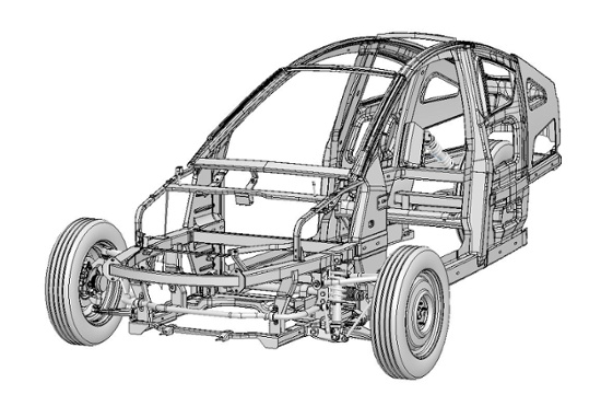

I was very happy and excited before when I saw that the Elio was going to have a tubular steel roll cage. They did computer crash simulations with the tubular steel cage protecting the occupants. It appears from the last few pictures of the E-series that hey are now using stamped steel instead of what was modeled in the simulations. Does anyone know how the 2 types of frame compare in occupant protection? To me this is a big deal that seems to have flown under the radar. Is this something we should be concerned with since one of the stated goals has always been to produce a 5 star safety rated car? Does it appear that they are cheapening out in the design now that we are getting closer to production? Does anyone know for sure if they have redone the crash simulations with stamped steel and have had similar results?

I would expect a stamped structure that re-creates a tube geometry (a full tube) to be as good as or better than a frame when given the same tube diameters.
A stamping would typically add flanges to the 'tube'. Having said that, I don't know the full tubes are being recreated exactly the same.
However, since it's a process involving some software, they would have already repeated the process with the stampings in place. It's setting up the process and method of analysis that takes the most effort. I'm sure they didn't want to go into that much detail for the public, since everything said costs them a lot of talk-time.
Generally speaking, for the crash tests I saw, just the beam-strength and a related deformity direction (for each structure) were the only attributes of each tube that affected the overall results. So long as the replacement segments are the same or stronger and with about the same relative strength to the rest of the structure, they will meet or beat the prior result.
But as I say, re-running the simulation again with an updated solids model is a trivial matter. So I'm expecting they did that. In fact I would have expected they did a comparative study early on while deciding what frame designs and manufacturing processes to use.
In any case classic automotive engineering has standard relative expectations for this type of change to a design.

Stamped steel can meet or exceed the ability of tubular steel--it all depends on the design.
From Elio's financials, we know they've contracted with a firm to do the computer simulations, but the purpose of these Engineering vehicles is primarily to crash them and get REAL results. So we'll find out just how well the simulations hold up. Since (we suspect) the changes to the frame has largely been due to Roush joining the team, I'm not worried :)

I think you have a different definition of "trivial" than I have. These sort of models take months to mesh and assemble initially and even though working from an existing model helps, it'll still take weeks of engineering effort to modify the model.
I agree with the rest of your statement, though.
