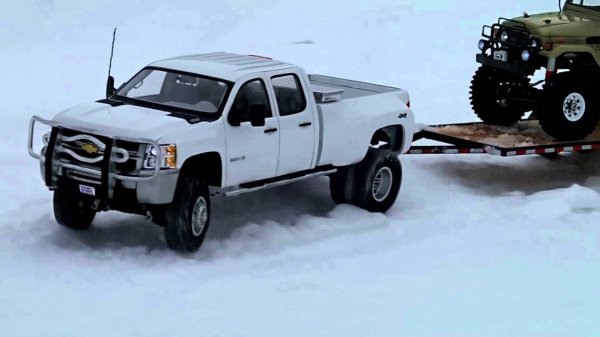

For starters, the gravel is wrong. It's too big. It's common practice in the model train hobby to use gravel that is too large for scale, because the real scale gravel looks like powder. The stuff that is too big for scale looks better, but it's also the wrong scale. That's what the gravel in your pictures looks like. It's the wrong scale.
Second, the brush guard across the front grille looks too rough. Typical of chromed, injection molded plastic. When you get in so close to get a picture, the imperfections start to show. That's fine for a scale model, but no one who slammed down the wad of cash that truck would have cost if it was real would have settled for what would be a shitty job for a an expensive brush guard.
Third: The antenna looks wrong. Too thick.
Whoever built the model did a very good job. And the photographer did a good job, too. There's nothing I can point to that screams "fake", it just doesn't feel right. But even so, there's no way that's a real, full-size Chevrolet Silverado dually.
Like I said Rob, you were really close the first time; and NSTG8R nailed it. It's an RC Scale truck hand made.
Here's the whole story on it:
Chevy 3500 Dually Toy Conversion by Karl Sandvik
About the only thing that gives away the scale of Karl Sandvik’s Chevy 3500 Dually work truck is the size of the hex heads on the custom steel frame rails! We’re suckers for a truck that nearly suckers us! Karl tells us he chopped up a Tamiya CC-01 front suspension for it, widening the suspension arms and substituting dogbones from a different Tamiya model to keep the 4WD functional. The powertrain is based off of an old RC4WD dual-motor transmission that feeds power into the original output shaft for the CC-01 rear axle. The rear axle itself was modified to accommodate RC4WD leaf springs for a scale-correct suspension. He had to fabricate a custom-length driveshaft to work with the long wheelbase. Power comes courtesy of a pair of Novak Terra Claw 55t motors and an Outcry Dual Motor controller. Rolling stock consists of RC4WD 1.9 Double Trouble II wheels wrapped in Dirt Grabber tires. The body began as a Newbright Silverado 1500 which required major plastic surgery using styrene to become a convincing 3500. New bedsides, rear doors, roof, windows, grille, hood, and bed interior (with battery stashed beneath) were required. There’s also a full interior and a set of magnetically attached tow mirrors. He brazed the brush guard, tube steps and rear hitch from aluminum. Front to back the scale authenticity is first-rate!
I'm figuring the size to be around 18" long, about 12" tall and about 11" wide; weight would be around 14lbs from the parts used it's a 1/10+ scale. It doesn't say how it's geared so I have no idea of speed or distance, but if it's typical, it can probably do 35 to 40mph.

Yes, it's well done. Lots of time, talent and effort involved.
Nonetheless, it still is a toy, and it still is a model. Even the article admits that it's a toy, and if it's not a model, the word has lost a great deal of it's meaning. It's hard to play 20 Questions when the "answers" are wrong. Poorly played.
Chevy 3500 Dually Toy Conversion was the title of the article; the body started off as a toy standard cab made out of Styrene Plastic; the definition of a TOY is - A toy is an item that can be used for play. Toys are generally played with by children and pets. Playing with toys is an enjoyable means of training the young for life in society. Different materials are used to make toys enjoyable to both young and old. Many items are designed to serve as toys, but goods produced for other purposes can also be used. For instance, a small child may pick up a household item and "fly" it through the air as to pretend that it is an airplane. Another consideration is interactive digital entertainment. Some toys are produced primarily as collector's items and are intended for display only.

Something not quite right about the front suspension links in the lower picture. I didn't blow up the pic, but the attach bolts look suspiciously like gigantic allen-type bolts. I'm no expert on Chevy front suspension (I'm a Ford truck guy), but I've never seen that configuration regardless of the tonnage rating.
FOUND IT!
RC Silverado dually!
A real truck would leave tire tracks in the snow.
