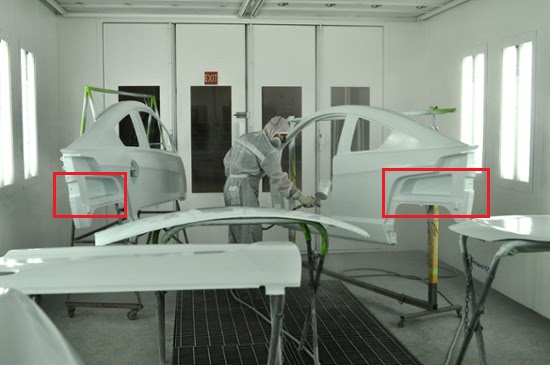

The Gas Cap hole is already in the Right side body panel.
We're talking about the panel on a stand towards the front of the picture
Here's the panel
And here's the Right body panel

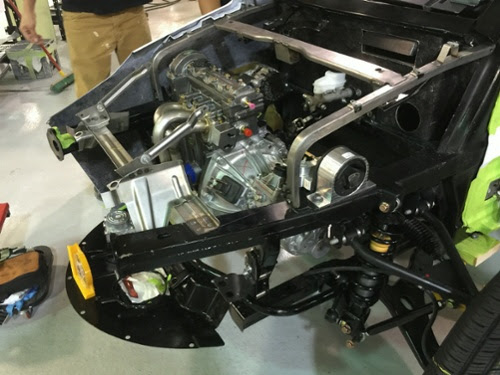

For those of you who are all about efficiency and power, here’s a great shot of the E-Series powertrain pictured in mid-installation, in position in the engine cradle. Note the engine stabilizing bar from the front support awaiting connection and the transmission mount on top of the frame rail, just above and to the left of the coil-over shock assembly.
The E-Series powertrain pictured in mid-installation, in position in the engine cradle.

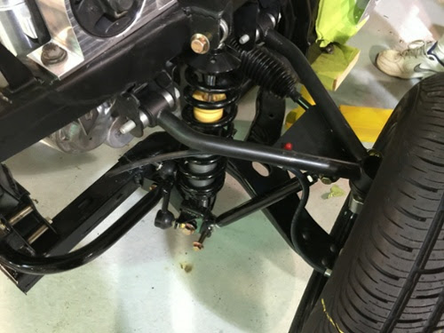

When it comes to the E-Series’ handling, it’s all about the suspension. This is the left-front suspension of the vehicle being assembled at the Pilot Operations Center. As we’ve mentioned previously, the E-Series has an independent suspension up front, consisting of unequal upper and lower control arms, incorporating a coil-over shock absorber design, which provides excellent handling and stability.
The left-front suspension of the first E-Series vehicle being assembled at the Pilot Operations Center.

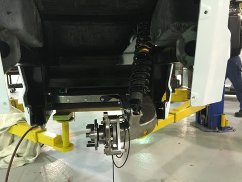

The E-Series’ swing-arm rear suspension also has been installed, with the ABS system’s electrical connection ready to be connected in this picture. Notice the multi-toothed ABS tone ring that is protected in the middle of the swing-arm assembly. When mounted, the E-Series’ rear wheel also helps provide protection for the tone ring.
The E-Series swing-arm rear suspension during installation.

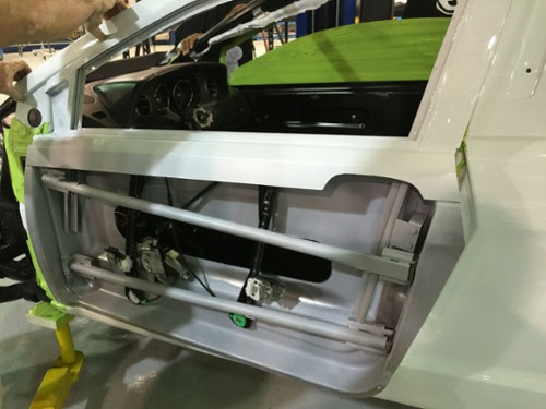

The driver’s door, which at this point has not yet had the door skin installed, shows both the power window motor and regulator hardware in place. It also shows the impact beams, which tie the hinge pillar to the B-pillars. The impact beams are designed to work as a system and play a strong role in absorbing energy. In the event of an impact, they are designed to deflect or catch and minimize intrusion and transfer energy load to other parts of the vehicle.
The E-Series driver’s door, prior to the door skin being installed.

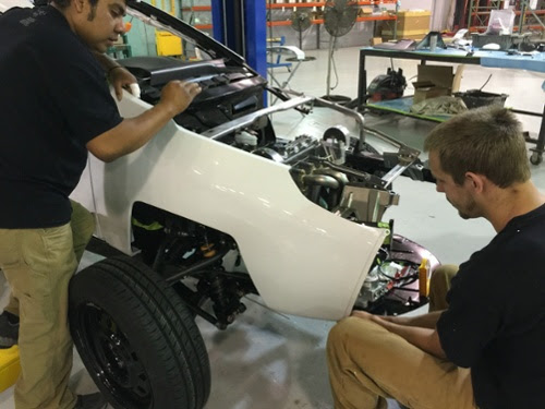

Elio Motors technicians position the E-Series’ front fender for attachment during vehicle assembly. The E-Series’ body panels are made from Sheet Molding Composite.
An E-Series front fender is attached during vehicle assembly.

I said earlier that we should shelve it until I hear back from EM; I wrote to them earlier; they responded and asked for a copy of the item we were talking about; I did send them the whole picture, and the panel picture at around 12:15 (slightly after noon o'clock) Pacific time and waiting to hear back. I think they went to track down someone at the Pilot Center.I vote with Coss first pic is definitely Da bulge.

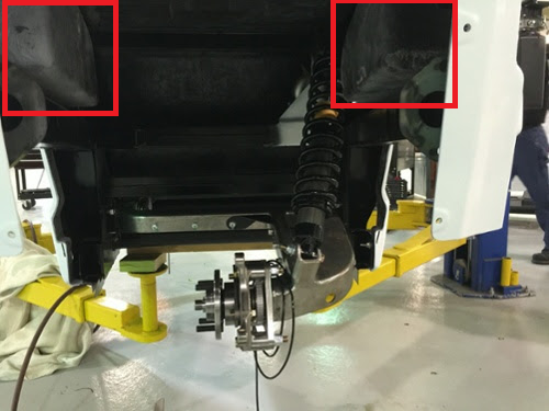

Those boxes I noticed beneath the rear tire skirting....
Today we get another glance at them from the other side. Looks like it could be for storing the can of Fix-a-Flat or somesuch.
