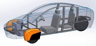

The rear tire will also experience the widest range of loads. The front load is relatively constant, there will always be a driver and always have an engine and transmission. The passenger seat is almost directly over the tire so the addition or subtraction of a 50-250lb passenger will directly change the load on the rear tire and possibly the driving characteristics.
airforceguy6
Aug 21, 2015
187
306
California
The rear tire can be made wider but a custom wheel would likely be needed to counter the offset.
Hi Crimson, I agree that a passenger will change the characteristics of driving, just like it does on a motorcycle when you have a passenger. However, the passenger is not directly above the wheel and suspension system, they are in front of it. So my guess would be that it will have some effect, but not necessarily significant.
Image for reference
