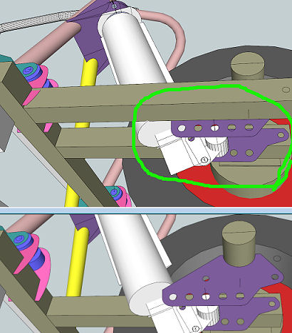

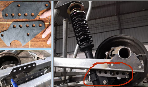

Lower rear strut swingarm mounting brackets, with adjustment holes, kind of looks like the drawing even .....
Just a thought now, mind you, but with the swing arm now being below the pivot, the wheel will have an increased rearward component (an eccentric?) to its arc in reaction to pothole impact compared to the original pivot location, which is a good thing; but, if the swing arm were placed above the pivot, that would lower the CG (ala Hudson), and increase the swing arm angle allowing the greater rearward component in the wheel arc. The pivot brackets would now be in compression and may require greater thickness. Just a thought.
The rear wheel was always going to be set to initially move rearwards, eg; pivot above axle line, for comfort and compliance. It also helps to keep the rear down under braking.
Currently the pivot location is just a guess'timate until I have set the final ride height, that's why there's a bit of length in all the pivot brackets, so I can adjust their shapes later to suit if required.
