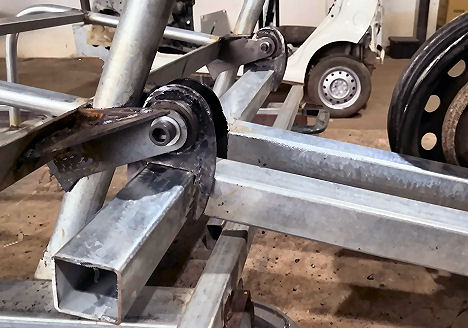

Turned the swingarm pivot mounts 90 degrees, this has shortened the wheelbase by 3", and placed some weight lower, which is always a good thing.
And made a pivot mount with bush to make life easy to attach it to the swingarm.

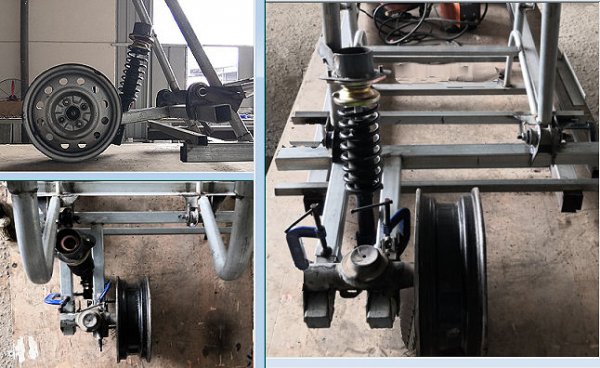

I'm quite please that the rear suspension is taking up very little space.
It's off to one side, low, and well forward, leaving lots of important space for luggage and rear passenger.
Bounce test went well, but hard to know until all weight is finalised, but have options to relocate it to change motion ratio later on. Bounce test here ...

Wonderful. What are your considerations on a brake; and, what is the story on the lovely, little bird in the background?
It's a normal common production rear wheel, hydraulic drum brake and cable parking brake.
