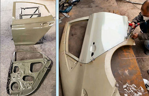

Getting to the bodywork a bit, and as I won't need rear doors, I cut out the inside panels of the doors mostly to get rid of weight for handling while doing the bodywork.
I then took those gutted doors and the rear side skins around the corner to my laser welder guy to create one piece rear sides to work with.

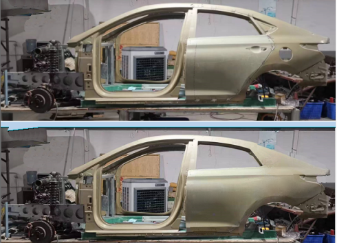

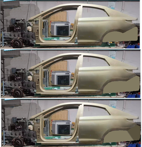

After joining the front and rear sections of the left body side back together again after I had cut them apart, I lined it up on the chassis again.
I then put the picture into Paint Shop and blended it in to get an idea of what it will look like.
Do the right hand side tomorrow ...
Have you made any decisions about how you are going to shape and construct the rear wheel well/arch?
