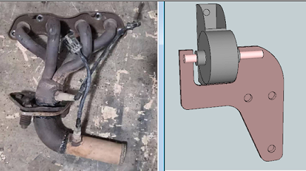

Mounting the steering rack, but it's a lot more complicated than it looks, as the lower front suspension mounts and firewall come into the equation, but as you know, you eat an elephant one bite at a time.

Fixed the bumpsteer by lowering the rack
Fitted spring back on suspension
Fitted front suspension
Fitted tie rod ends
Sat engine into position
Started on engine mountings.

I'm very happy to see that a catalytic converter is not directly attached to the exhaust manifold. Those are a pain to replace.
I assume you are going to put the catalytic converter further down the exhaust system?? Or will you be able to get away with having none at all??
I do know my Yamaha (motorcycle) has a catalytic converter at the end of the exhaust system (right before) the (chrome) exit tip. I think its a combination cat and muffler....
