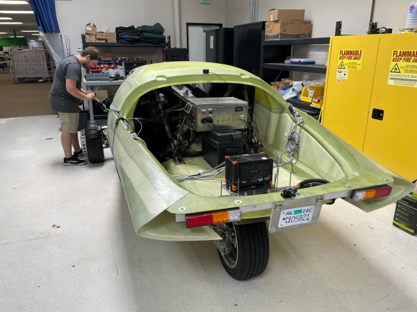

It's the 2nd build, and it's a pre-production build. The prototype was the black one.

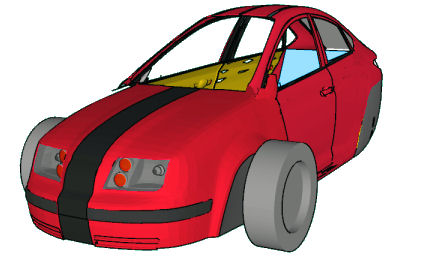

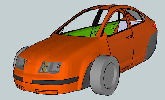

Over the next week or 2, I am going to try a narrowed VW Bora/Jetta nose for size.
This doesn't mean that's what I am using, it's just that I have a Bora going to waste in the factory, so I can try it out, and get practice in for narrowing a nose, rather than buying new panels and doing it wrong.
The Bora is actually one of my favorite car noses, and the nose panels are highly sort after by VW Mk4 Golf owners as they bolt straight on. They then call them "Bolfs" by the way, Google it if you don't believe me
Added red one with racing stripes for the rev-heads ...

Will the engine's radiator get enough air flow?? I'm not seeing a grill, just some area at the bottom for air flow.
The headlights and turn signal pods look like they take up a lot of real estate on the front facia/nose area, just wondering how much air is needed to cool the engine's radiator.
Probably not an issue for most people, but I'm in the desert -- we routinely see temps over 110 degrees (Fahrenheit)
