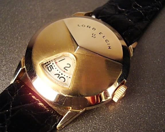

Ya, maybe we need prince Charles or perhaps the Queen mother herself or at least someone from the royal family to help clue us all in, why a American vehicle needs the assistance of Lord Elgin's help in designing anything, a dash, a dashboard, or sir lord Elgin could you please remove that not to dashing looking fellow, Charles from the back seat of my Elio...Why thank you!

Here is a photo of a Lord Elgin watch which seems to have inspired Paul's instrument panel design. I believe they were popular in the forties or fifties. :cool:
