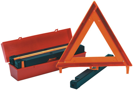

Well I thin the third brake light thing was because passenger vehicles such as cars, trucks, vans, SUVs are wide and have tail lights that are set apart from each other, the third stop light creates a triangle basically. Like the warning triangles for safety.
The Elio is very narrow at the back so the lights are right next to each other, like a motorcycle, negating the need for a third light.

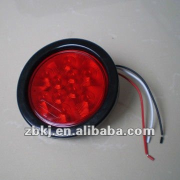

I am going to put a white or amber (depends on color of factory turn signals) on the front and red on the backside of the front fender fairings, both front and rear wired for park and turn lights.
I was planing to do the same. Something flat
or like this
depending on space
