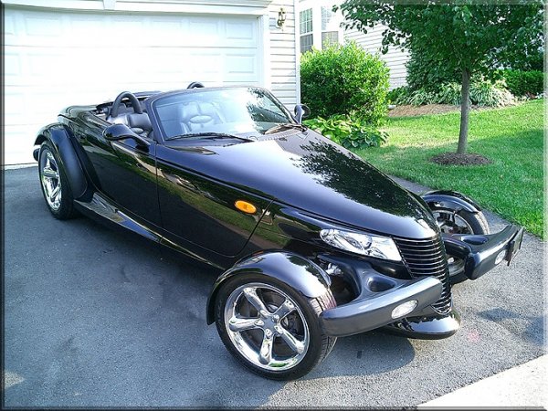

The Plymouth Prowler didn't have lights on its fenders.
