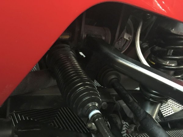

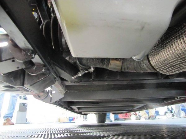

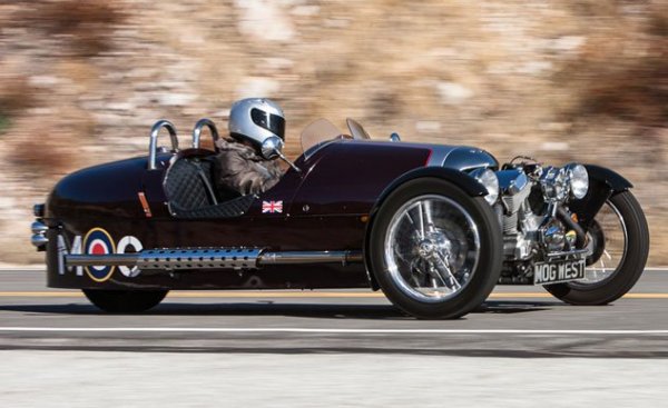

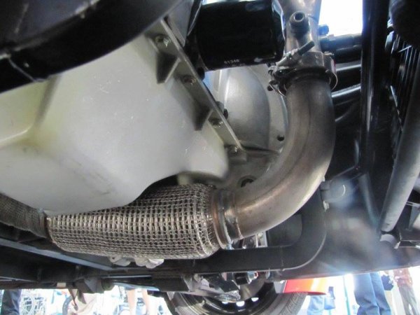

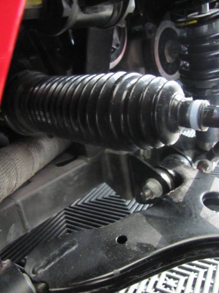

Here are images of the routing of the exhaust in the P5 and E series. If being routed directly under the oil pan (requiring a wrap to insulate from the engine oil) is already not bad enough, the tight routing aft of the engine, over the frame, under the steering linkage is just as troubling. Then it routes under the resin 'bulge' panel that really cannot be removed to express the exhaust pipe. See the gap in the body panel behind the exhaust pipe to accommodate the exhaust? Removing that 'bulge' panel is inelegant. The whole exhaust system could and should be reevaluated and resolved better, possibly by redesigning the manifold and taking it horizontally out the passenger side of the engine bay. The Morgan is a conceptual inspiration.

You said: " If being routed directly under the oil pan (requiring a wrap to insulate from the engine oil) is already not bad enough, the tight routing aft of the engine, over the frame, under the steering linkage is just as troubling."
That is a very good point. I did not realize the exhaust squeezed between the frame and steering linkage as it does. Without wrap, it could melt the rubber boot around the steering linkage. Are they going to heat wrap that part in the production version? I have heard multiple people on this forum say heat wrap induces rust on exhaust pipes.
The exhaust pipe is so small and the bulge is so large in comparison, are they going to put other things in the bulge too, thus necessitating the bulge being that large?
Yes, without a belly pan, the underside does look un aerodynamic. Considering the current design, I would prefer the exhaust running under the vehicle, even if it did hang down lower. It would get rid of the bulge (and thus be less expensive to make), and make for a cleaner design.

Don't compare any of the exhaust routing of the P5 with the final vehicle. The P5 actually had two separate exhaust systems. The functional exhaust system exited out the back of the vehicle, near the swing arm for the rear wheel. The exhaust system in the bulge was nonfunctional. As such, you can't count on any of the P5 exhaust system to have any similarity to the routing in the E series, or the final vehicle, and you should ignore all pictures of the P5 when considering it.
I'd rather have the bulge than lose ground clearance. Good ground clearance helps with potholes (which are a problem for 3 wheel cars - - you can't dodge 'em), helps with driving in snow, and help with badly-done curb cuts, which abound.
I would pay extra for a belly pan.
