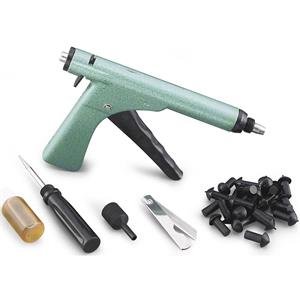

I'll just carry this and the inflator as I do now in my smart :D
And my credit card of course :p
