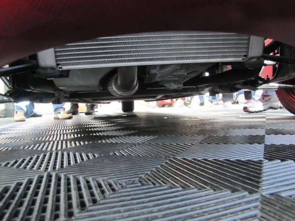

Having the exhaust exit down the side makes cleaning up the bottom of the vehicle (smooth belly pan) for aerodynamic reasons MUCH simpler. I'd really like to see a pic of the bottom of the Elio (P5).
This one is from Goofy1

Pop quiz ........
Wonder how many people noticed .....
The zerk fitting on the upper "A" arm ........
The braided brake cable routing along the upper "A" arm ..........
The lack of a grease fitting on the rear swing arm .......​
Just minor details to tweak in production.
I am curious to hear your interpretation of the problems these things pose for a production vehicle.
