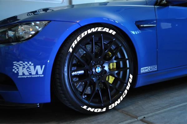

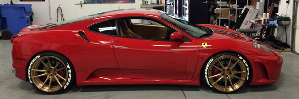

Didn't white letters go out of style in the 80s?
Edit: every tire I've ever seen is lettered on both sides.
because race car
Just because want to be race car. This company makes kits to do this to your tires its hella expensive though

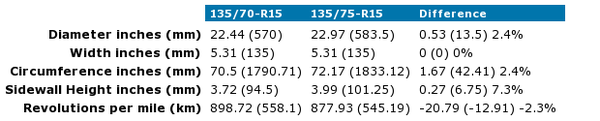

An interesting comparison of the 135/70-R15 and the 135/75-R15 tires on Tacomaworld.com:
The dimensions of the tires gives you a better idea of how they will scale with the car - and there isn't a whole lot of difference between them. I'd opt for the slightly larger 75-series tires if for no other reason than to gain a fraction of an inch of sidewall that would, in theory at least, provide a tiny bit more compliance.

Would this be the difference between front and back or just comparing the two sizes?
the two front tires in possible sizes. the rear will be wider than the fronts
We are not sure if the rear will be wider than the front or not. It has been discussed both ways at times. Just one of those details that are TBD.
My guess is that EM does not want to use a different size for the rear, saves money to only have one tire all the way around, however we will see how it all plays out. My guess is that testing will be the determining factor.
