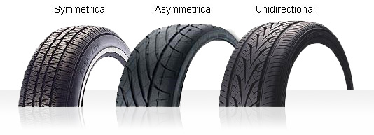

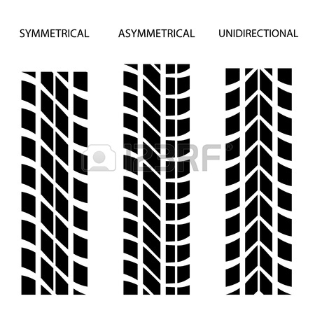

Wheaters would be correct. Tires come in directional and unidirectional rotation as well as with symmetric, asymmetric, and unidirectional tread patterns. EM will simply use a unidirectional tire as these do not have an inside or an outside.
