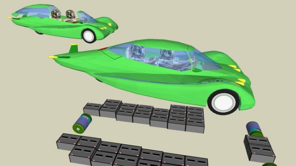

If Elio2 is redesigned for full EV, that would likely balance the decision back to a full body. i.e more like this LongRanger (image below), which has bue-que space for batteries, and Even three motors for All-Wheel-Drive.
