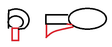

I have a gut feel that you may have to beef up the linkages and side view mirror connection in the 3-D printings to avoid easy breaking of those parts.
I have thought of the issues with the mirrors and the suspension. The mirrors are the more difficult thing and I may even have to leave them out for smaller models. I will likely end up with some kind of support base across the front end to support the outrigger wheels and the front end of the vehicle thus taking the stress off the suspension. All part of the process.

You can also just add a gusset ( in red ) below the mirror arm as they do in toys and simply accept the variation from reality.
10,995
Thanks, that is a nice solution to try. I will have to experiment with it.
